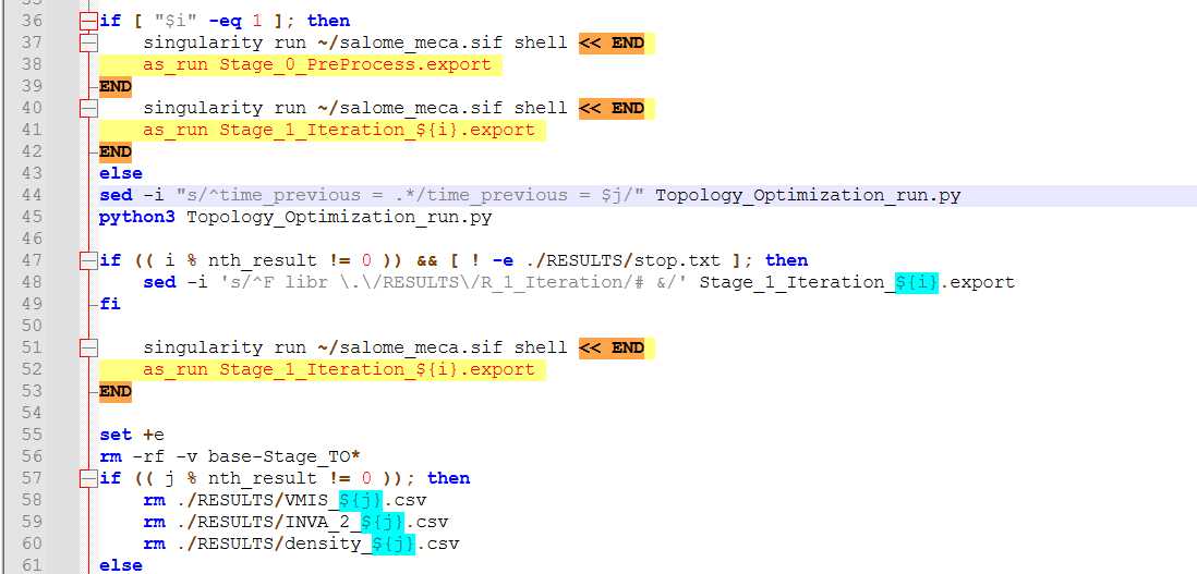

I tried to run the first beam example on my computer but I have some difficulties.
I have no experience with Linux and WSL and Python that's why I used AI wherever I was in trouble.
Now I have an issue with Line 37 of run.sh. I get this error:
smeca-user@DESKTOP-6FMARRN:~/optim/STUDY/beam$ bash run.sh

/home/smeca-user/optim/STUDY/beam/temporary
aim_volume_fraction: 0.4
Iteration: 1
FATAL: While checking container encryption: could not open image /home/smeca-user/salome_meca.sif: failed to retrieve path for /home/smeca-user/salome_meca.sif: lstat /home/smeca-user/salome_meca.sif: no such file or directory
This is how I have changed Line 37 from your original code:
I guess it is probably something wrong with my wsl, singularity (apptainer) settings. But I couldn't figure out how to fix it.
Any suggestion?
