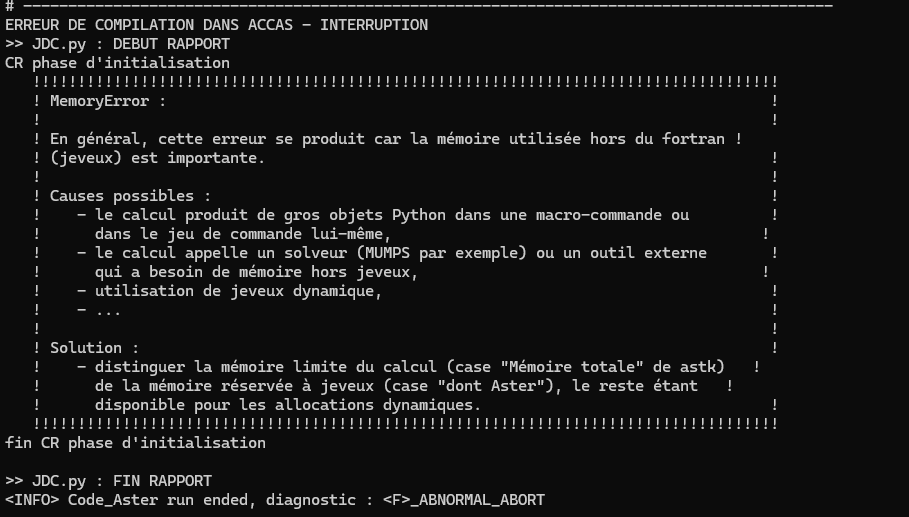

I’m getting a MemoryError during the initialization phase of my Code_Aster run. The message says that the memory used outside Fortran (Jeveux) is too high, and the calculation stops with <F>_ABNORMAL_ABORT.
I already increased the memory in export file:
Mémoire totale = 4000 MB
Mémoire dont Aster = 3000 MB
But the problem is still there.
How can I fix this? Any advice would be appreciated.
You will find here my export file and the image of the error
