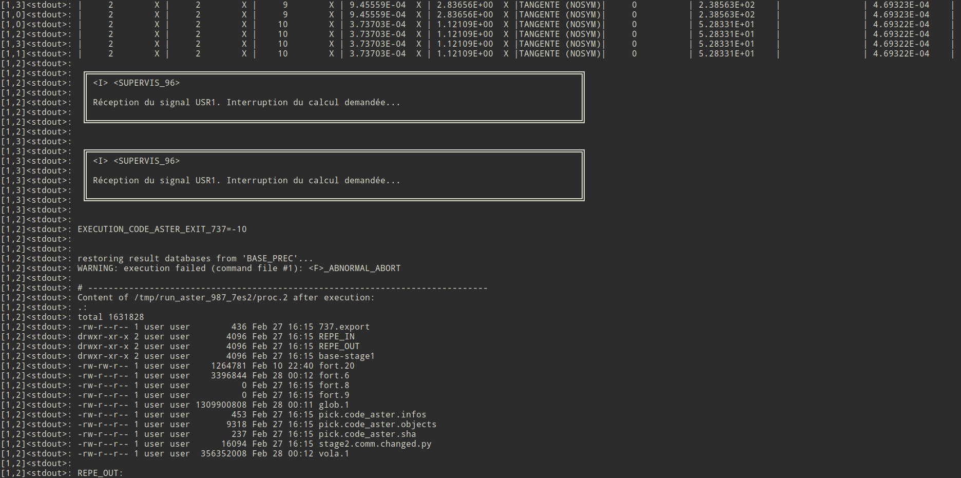

Also attaching image of terminal.
The post process of writing med file command is not done. This errorr happpens more when there are large time steps already computed. This is worrisome because for large studies,the results will not be created.
Much thanks if I could know why this error is occuring and how to avoid this error .
